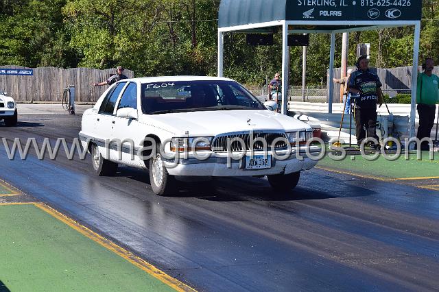

I have a 95 roadmaster (stock w/headers & 3.42s) that I bracket race & daily drive. Has run 14.66 at ~1900' DA with 2.05 60' (4400+ w/driver). Stock FE1 (soft) suspension with Monroe severe service shocks, a junkyard rear swaybar off a ford sedan and sticky rubber (consistency).
Currently have the motor out (cracked head). Going to put it back together with a little more cam (GM 395), 1.6s on the intake side, and a 10" 3k stall converter. Hoping for a 13.99x downhill with a tailwind in mineshaft air. :D
