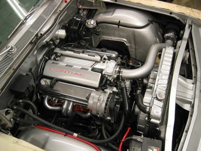

I gave the car to my son around 2004 and the 400 was a gas pig. We bought a 1995 Impala SS driveline, wheels, spoiler and wiring for $1400. We rebuilt the engine .030 over and the trans rebuilt too. I cut up the injection harness and merged it into the Pontiac. I have good details for the Gen II engine swap, documented in Excel format if anyone wants a copy. My son added Hotchkiss stabilizer bars. Power steering box is G-body and it has disk brakes up front. Coils are cut.

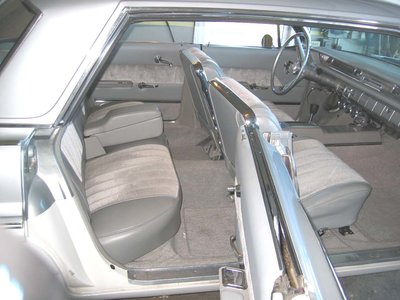

Seats/console are 1962 Wildcat Buick. Alpine stereo and amps.

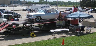

The Pontiac is a nice cruiser. The car is 400 lb lighter than my Impala SS which has run high 14's.
