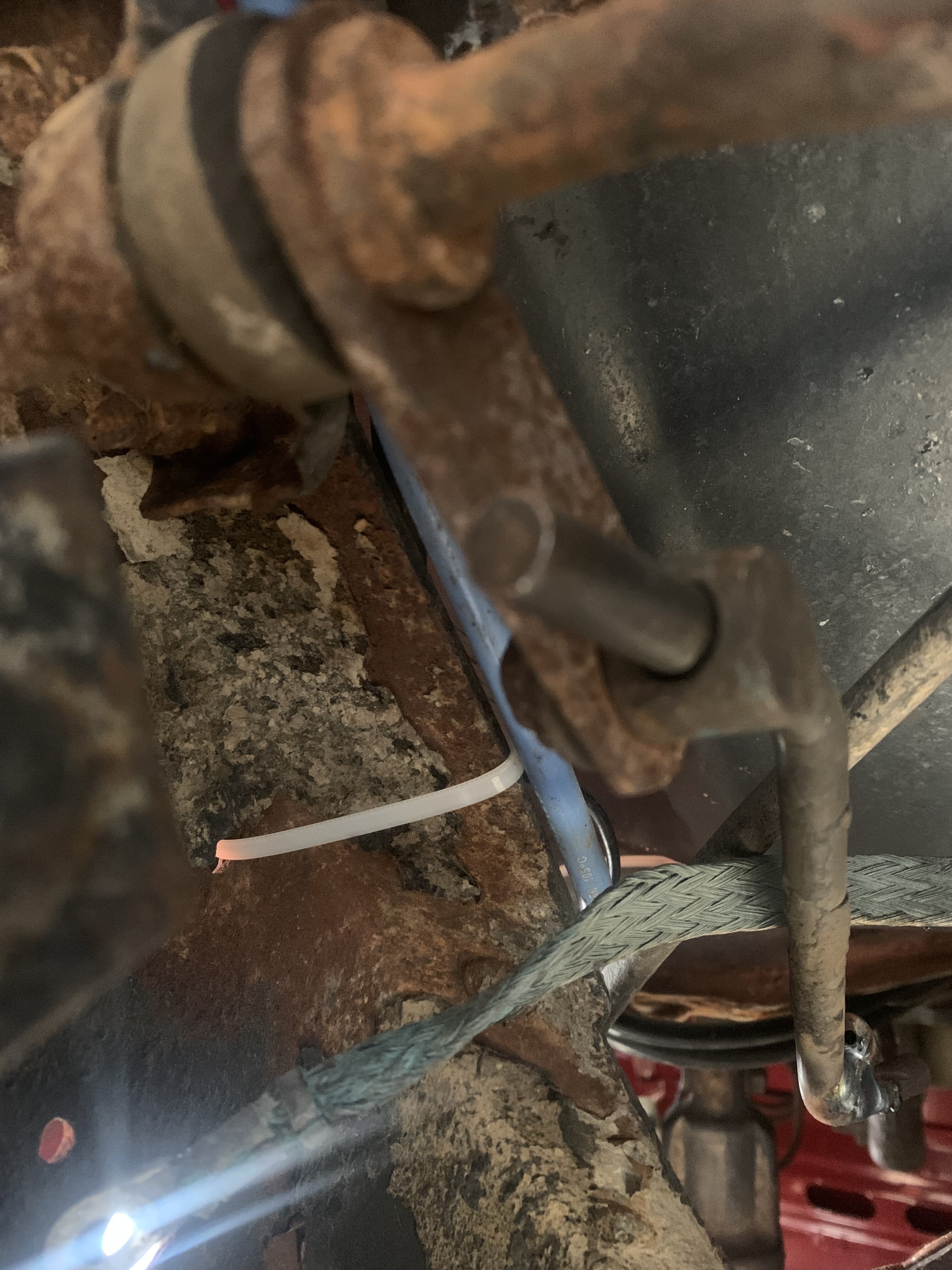

The mechanical linkage has and adjustment on the rod that comes down from the steering column, it's a bolt that pinches the rod
This pic is an 83 GMC pickup but same idea, the head of the bolt in the pic is inline with the blue cable
Turns out that this is exactly how it's setup on my Caprice. I was finally about to spend the time to get back under there and get it fixed. Shifts into PARK perfectly now. It's nice not having to finagle the shifter until the car stops rolling down a hill.
